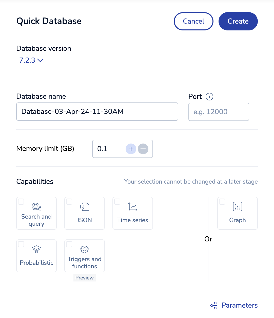

Create a database
  1. On the Databases screen, select Quick database.
    Select Quick database on the Databases screen.
  2. Enter 12000 for the Port.
    If port 12000 is not available, enter any available port number between 10000 to 19999 or leave it blank to let the cluster assign a port number for you. You will use this port number to connect to the database.
    Create a quick database.
  3. Select Create to create your database.
When you see Database active appear on the database configuration screen, the database is activated and ready for you to use.
Database active icon.
You now have a Redis database!
