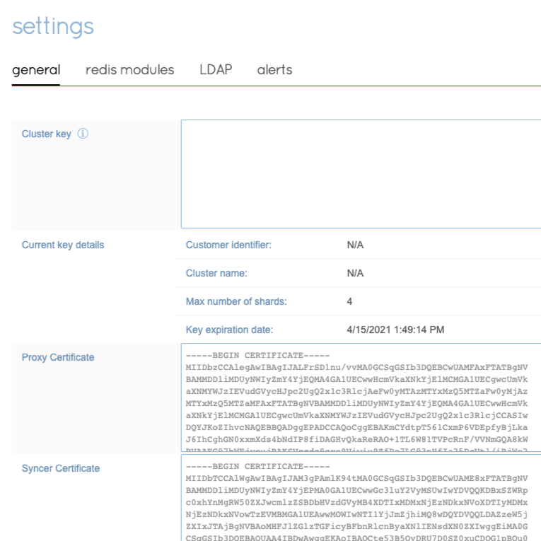

Retrieve syncer certificates
For each participating cluster, copy the syncer certificate from the general settings tab.
general-settings-syncer-cert
